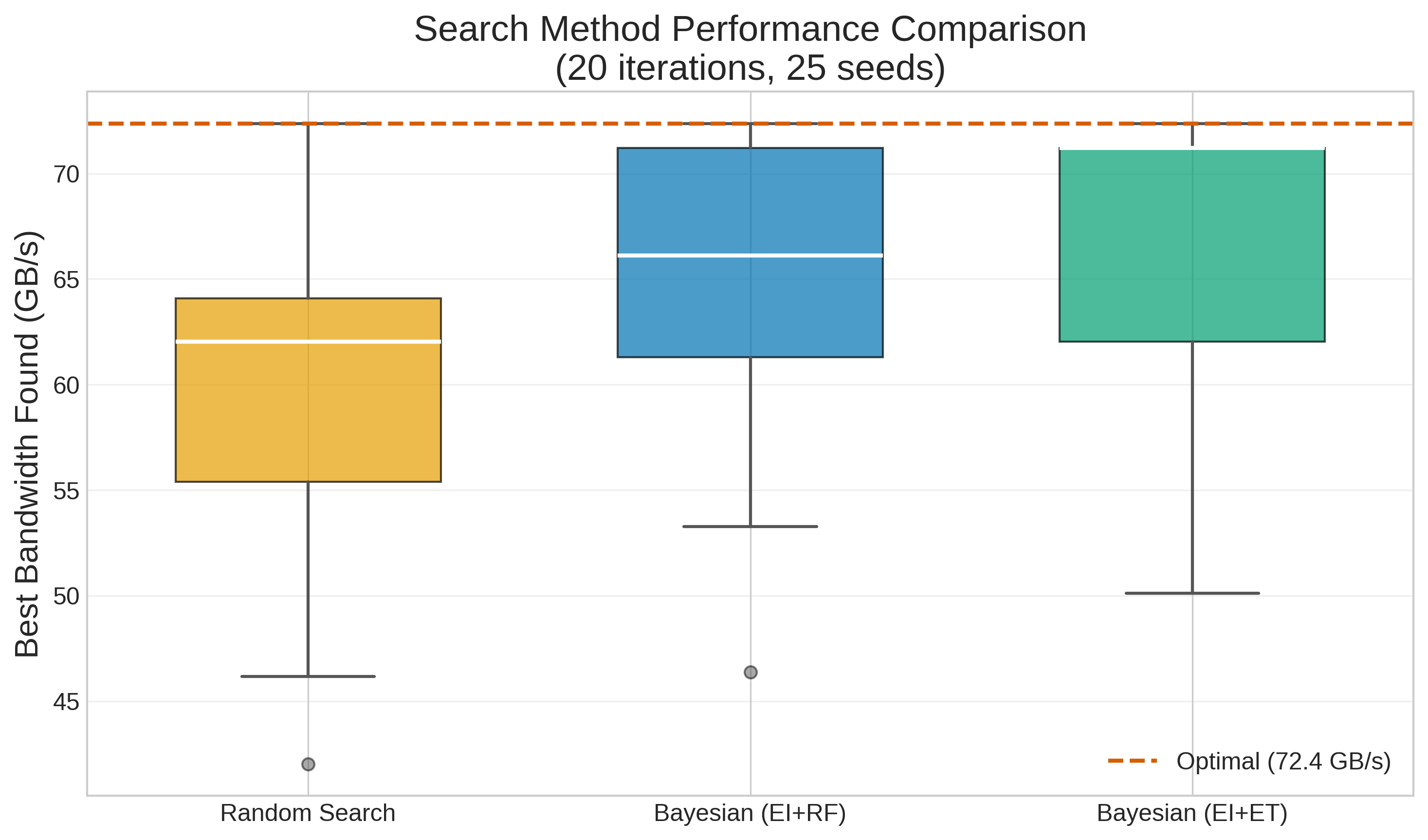

The boxplot below shows the best bandwidth found by each method across 25 seeds:
Performance Boxplot
The optimal configuration achieves 72.4 GB/s. Bayesian optimization finds configurations within 10% of optimal in most runs, while random sampling shows higher variance and generally lower performance.
Search Effectiveness
Percentage of Optimal
Bayesian optimization achieves a 10 percentage point improvement over random sampling while exploring only 6% of the parameter space. The Extra Trees (ET) estimator provides a slight edge over Random Forest (RF) for this workload.

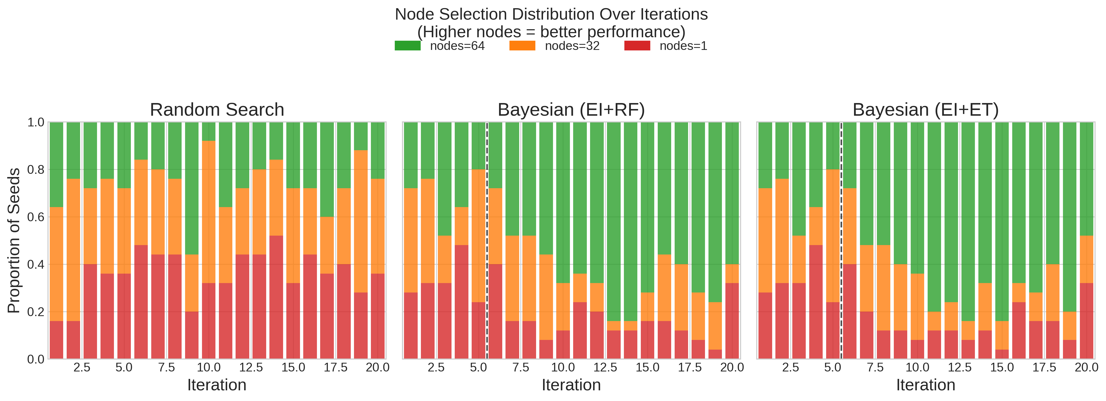

More importantly, the nodes parameter dominates performance in this workload. Since it has only 3 values (1, 32, 64), random sampling has a 33% chance of selecting the optimal node count on each iteration. The figure below illustrates how each method selects node counts over iterations:
Node Selection Distribution
The y-axis shows the proportion of seeds (out of 25) that selected each node value at a given iteration. For example, if 20 out of 25 seeds selected nodes=64 at iteration 15, the green bar would show 0.8 (80%) at that point.
The Bayesian methods quickly learn that higher node counts yield better performance and concentrate their search accordingly. By iteration 10, nearly all seeds are selecting nodes=64. Random sampling, by contrast, distributes selections uniformly across all node values throughout the run.
